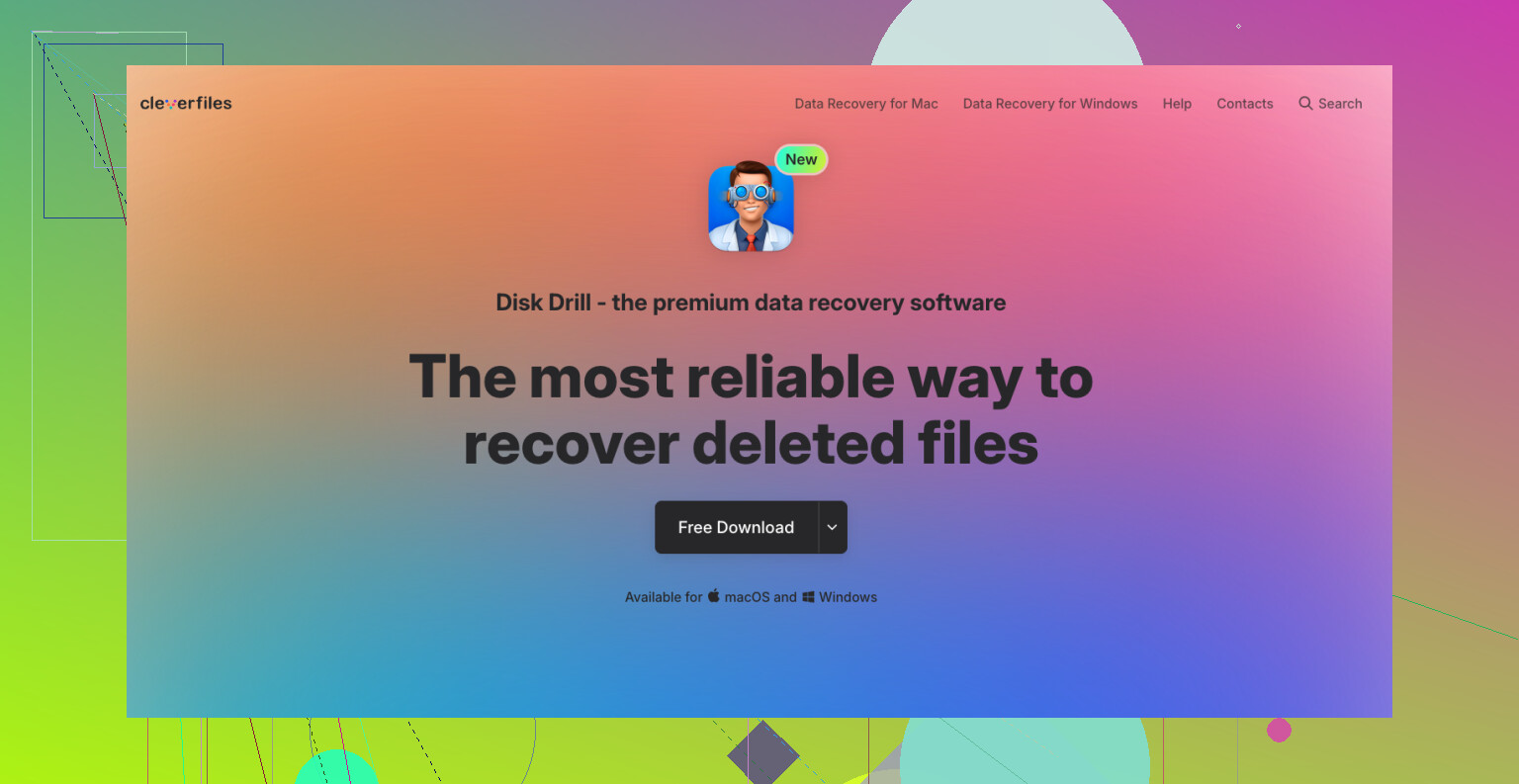

If the card is detected, scan it
If your computer sees the card, I’d move straight to recovery software. Disk Drill is one option people use for CF cards. It supports common card formats like FAT32 and exFAT, and it usually finds photos, videos, and RAW files if the underlying data is still there.
The preview feature matters more than people think. I like being able to check if the found files are intact before saving a pile of junk to a drive.

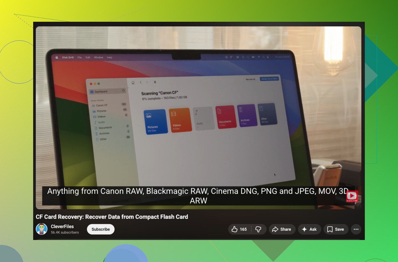

The basic recovery flow
  1. Remove the CF card from the camera.
  2. Plug it into your computer with a proper CF card reader.
  3. Install the recovery app on your computer, not on the CF card.
  4. Pick the CF card and start a scan.
  5. Look through the found files and preview the important ones.
  6. Save recovered files to your computer or an external drive.
Not back to the same card. Never back to the same card.
