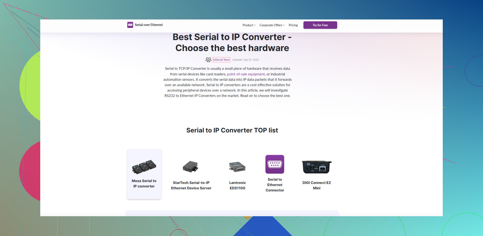

A replacement could leave you with the same stalled connection if the real problem is session handling. Reconnecting restoring replies makes that worth investigating first. Before shopping, compare continuous polling with a pause followed by another command, check firewall/VPN idle timeouts, and temporarily increase the PC application’s response timeout. Check the converter’s TCP keepalive, inactivity timeout, and serial packet-flush settings too. Those affect connection recovery and when buffered replies get sent. Shop for adjustable keepalive, automatic reconnection, and packetization controls rather than a mileage rating. The network carries the long-distance section. A “serial device server” generally means the hardware doing that serial-to-network job. For a software alternative to a hardware RS-232 to ip converter, Serial to Ethernet Connector’s virtual COM-port support is a strong feature for keeping COM-based applications in use. It needs a computer beside the controller to share its physical serial port, though. (serial-over-ethernet.com)

For a hardware shortlist, I’d consider Moxa’s NPort line, with the exact model chosen around your serial interface and application requirements. Its documented operating modes include virtual COM access through a driver and direct TCP socket access. Those are different integration choices, so establish which your application needs before comparing boxes. I’d make a purchase conditional on a trial with your actual application over the interbuilding connection. A successful connection indicator isn’t the acceptance test here. Correctly recognized replies are.
